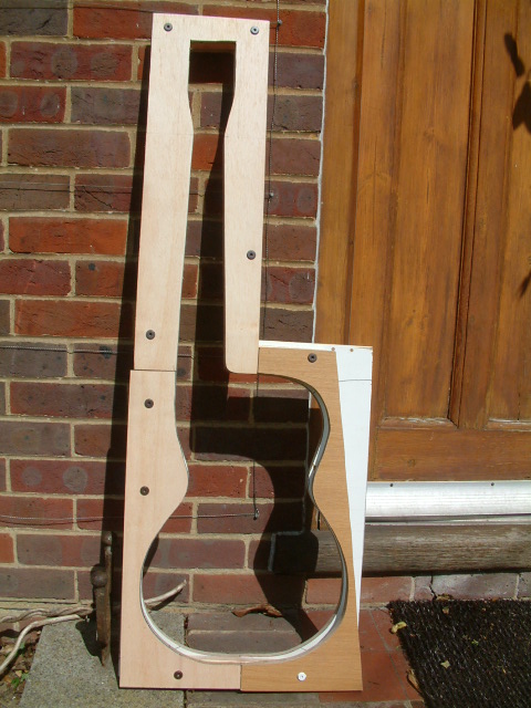

First the mold (Heath Robinson inspired ):

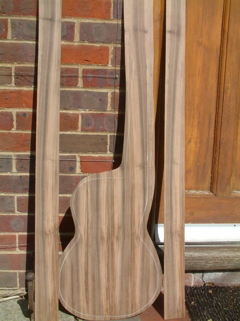

The back and sides:

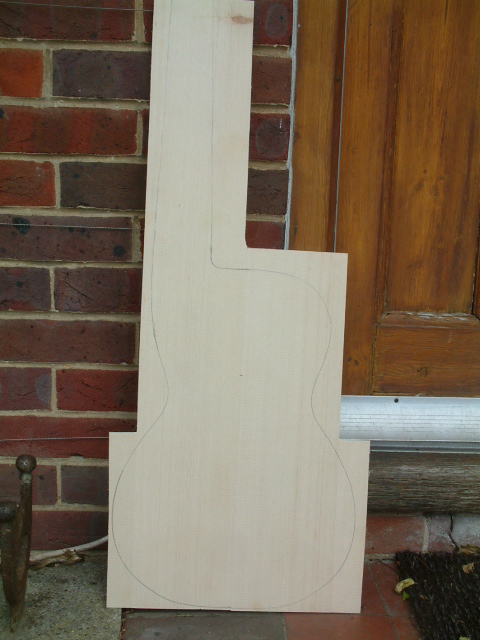

And the top:
